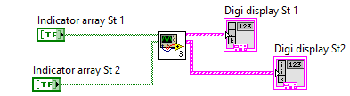

Hi.  Someone showed me a nice display that looks like;
Each of these is feed with a boolean and a string indicating the background colour and the text displayed (respectively).  Each is a cluster and is within an array of clusters.
The management of this is with a program like;
My wish is to get the most elegant way to put the indicators into the controlling vi and in-turn have the FP of this vi embedded into the parent's FP.
Also, multiple locations may need to be used/displayed on the same FP.
PS; If it's all too hard then I will have to use variations of the above.
Regards JC.....

Do you just want to have the same indicators in your main VI as in your subVI or do you actually want to have the entire front panel of subVI in your main VI?
If it's the first you can just copy indicators from subVI and paste them into your main VI.

Have a look at this post of mine. Seems you want to do the same thing that was requested over there:
Sub Panels

Consider making an XControl (or a Y Control)
This is not a VI, just a control that you can place anywhere on the front panel (multiple copies in the same front panel, in several VIs, etc. You need to make it a suitable type-definition so you can globally make changes if needed.
(Embedding a front panel as sub panel into another VI seems like a different topic, but please clarify your requirements in more details)

Hi.  Thank you for your comments.
I check out Sub Panels of Dobrino.  This would do the trick (of being an embedded "object" from else where).  I presume that this technique would always treat the FP of the other VI as a simple whole unit. (?).
I am unsure about my initial wish.  However, a previous technique that I forgot about and have used is;
To use a reference to the FP indicator, and pass into a VI (along with the simple IO request).  This in turn updates the FP of the parent/calling VI.
