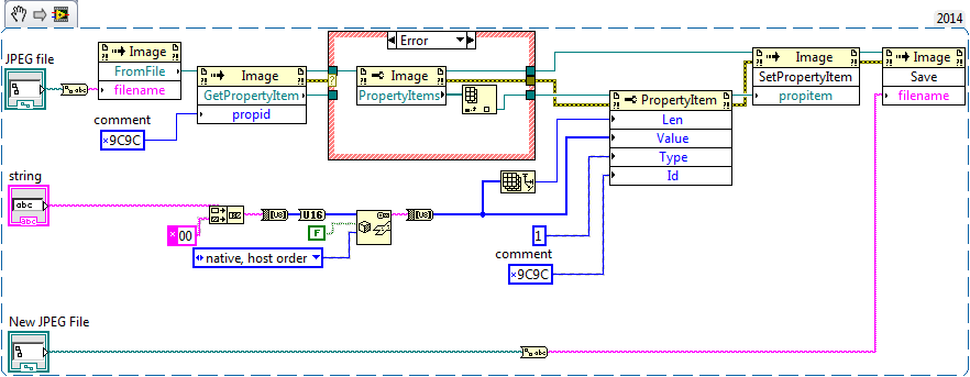

Here is code I used a while ago to add a comment to a JPEG file.  It will show up in the Details tab if you right-click in Windows Explorer and choose properties.
I seem to recall that the Microsoft folks thought they were being clever by not providing a constructor for a PropertyItem, this was meant to limit you to modifying existing tags.  If there is not an existing comment tag I just grab the first property item and overwrite all of the fields to effectively create a new tag.  If you are going to get Unicode-y with your comments then create an encoder object instead of just blowing up to U16.

1) Do you have the code in LabVIEW 2013 format?

Where did you get the PropID number?  I was using the list found here and couldn't get it to work.
That page says the comment field is 0x9286....not 0x9C9C.

LV2013 Version attached.  The metadata will show up in the file, it is not really obvious.  I may try to get an ascii property to work if using Notepad is more important than viewing the property in Explorer.
I seem to recall getting the prop ID by manually adding a comment from Windows Explorer and then reading the properties using the .NET functions.  I believe it is a Windoze-specific code, but the problem I had at the time was to get the comment field to show up.

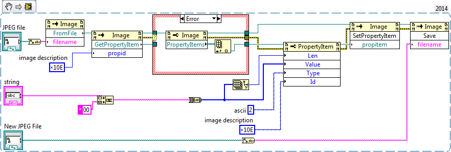

Edit:
Using the description works with ascii, easier to find in the file itself.  Shows up as the Title and Subject in Explorer.

I don't see anything in explorer though, Right click image file - Properties - Details Tab > Title and Subject are blank.  Are you using Windows 10?
But the text does show up on top within the image in ascii mode when read by notepad.

I am a bitter clinger to Windows7, but I looked at a file on Win10 and the info I added shows up.  If you have a specific file you want me to test, attach it.  It is possible that if your file has no PropItems that it will fail.

Noted on the potential issues with the text at the end. This EXIF is good enough for me.
Just for my understanding, how did you get the Title and Subject propid exactly?

I found the propid using this link:
https://www.exiv2.org/tags.html
I just looked for an ascii encoded tag that looked reasonable.  Don't go adding War and Peace to that tag...
