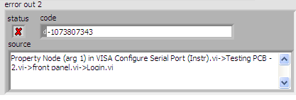

                 I am using microchip USB to serial converter and working with VISA. Sometime what happens my application generate this error, but equivalent COM port it shows in device manager, but doesn't shows in VISA resource name after I do referesh also.
Later I simply restart my application, turn OFF and ON the device and it works afterward and after sometime same story
Is this driver problem?

Will unchecking this solve the problem?

Unchecking that didn't solved i.e. USB ROOT HUB PROPERTIES
