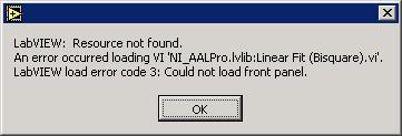

Does the error message also mention error code 3 like this?
If so, I would look through  "LabVIEW Load Error Code 3: Could Not Load Front Panel" When Running a LabVIEW Executable"
Misha
