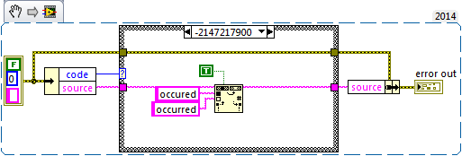

I'm guessing this is a problem because you display the error message to the user and it doesn't look professional to have typos in the error message...
...as a workaround for this specific case, you could simply do a 'find and replace' on 'occured' with 'occurred' on the error source.
Something like this should work:
