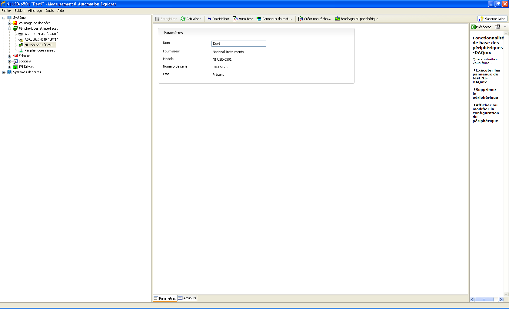

@USRP wrote:
When i run the script "USB-6501 Interactive Control.llb", i have this error  "Device identifier is invalid"?
What do you mean by When i run the script "USB-6501 Interactive Control.llb"...???

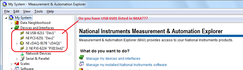

--> Do you've USB 6501 listed in MAX, as shown in the picture below...???
USB 6501 available

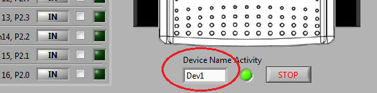

--> Are you using correct string identifier as device name...???
Is device identifier correct

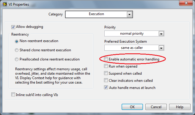

Ohh I see..!! Its debug time now...!!
Enable Automatic Error Handling:
Run the code, let the code come back with the exact location, where error is occurring..!!

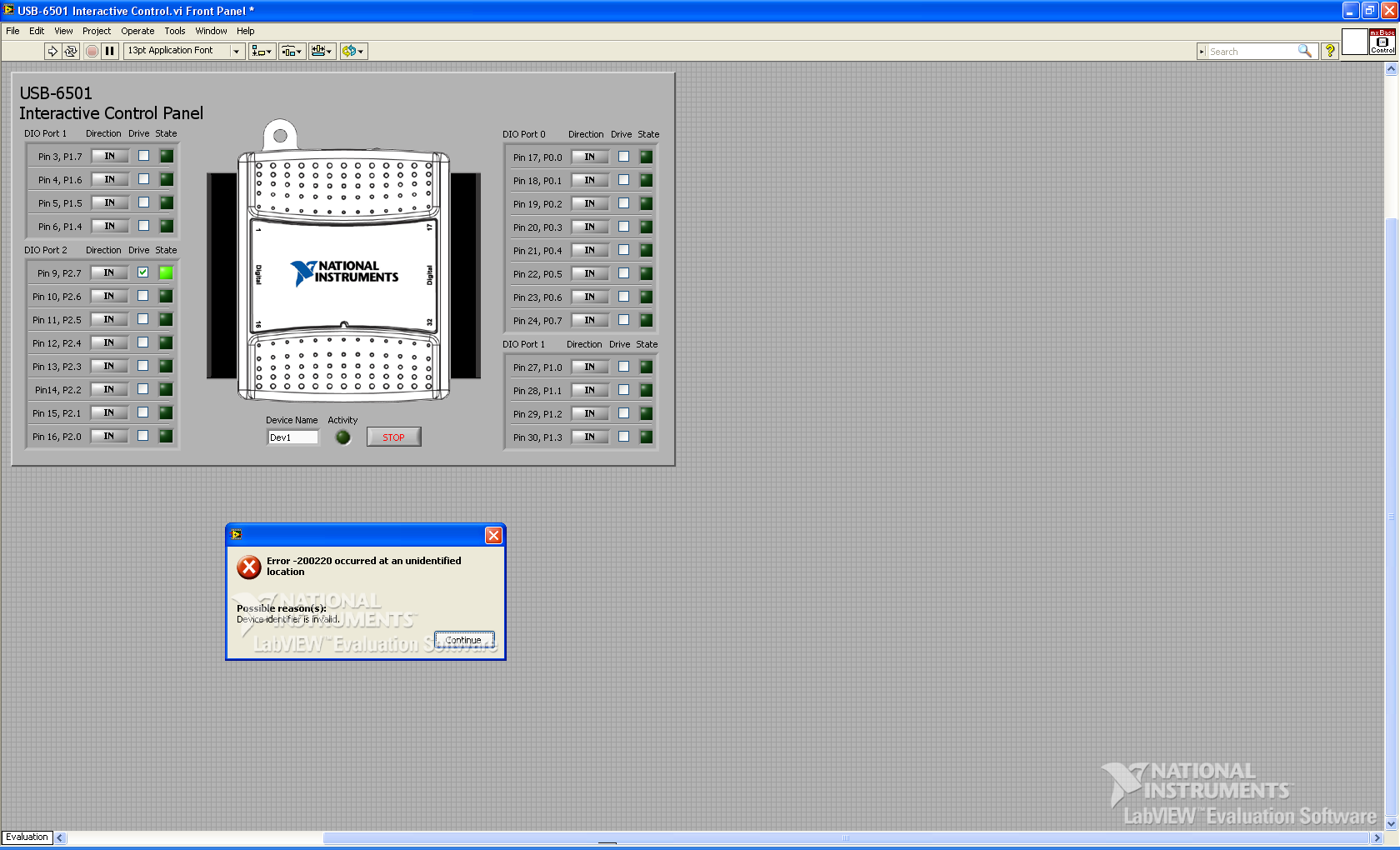

I did Enable Automatic Error Handling
I have the same error!!!
