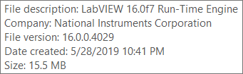

Did you look at this this Knowledge Base article?  When I followed its suggestions, and hovered my mouse over a lvrt.dll file, I found the following popped up ...

I believe this is a Windows function, possibly .NET.  You already know that the files you need to find are those in the folder (for 32-bit LabVIEW) C:\Program Files (x86)\National Instruments\Shared\LabVIEW Run-Time\<LV Version>, and that they are named lvrt.dll.  Go find one of these folders, right-click and look at its Properties -- Windows will show you the same information I posted in my earlier reply.  At one point, I wrote VI that used .NET calls to pull up these data, so I'm sure you can find these calls on the Web, and have them work just fine in C#.
