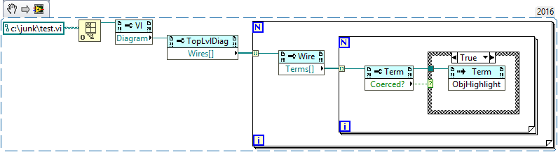

So, the answer is "Yes you can find coersion dots fairly easily with VI scripting".  Something like this would do what you need.
(6,323 Views)
It's too late to edit my post, but I realized the above code won't quite work... it wouldn't find coersion dots on any code inside of a structure, loop, etc.  You're going to want to use Traverse for GObjects with a class name of "Terminal".
(6,302 Views)
I still kudo'd but you also should be closing the VI reference when you are done, otherwise you'll have a memory leak if done on a folder of VIs.
