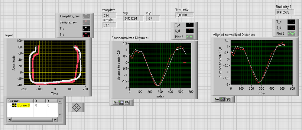

I don't have a solution, but some advice:
I'd work with distances based on centered x,y coordinates,
because then you can compare the Template and Sample as  1d arrays
e.g. to calculate a Similarity Quotient
The problem is still to scale the 527  sample data points to the 554 template data points.
I'd say there is no general algorithm to do this.
In this particular case it looks like you can simply cutoff the missing 27 data points of the Template Dataset:
This could be a (happy) coincidence!
By the way:
I normalize the distances just to visualize, why I think it is valid to cutoff the last 27 Template data points in this particular case.
To calculate a Similarity Quotient, I divide the sum of the sample distances by the sum of the template distances
Alex
Message 2 of 16
(4,355 Views)

Yes, but I have the code on a different computer - and I want to polish a bit before uploading to the forums.
It's a bit spaghetti'ish, as  you will need a separate For-Loop for each Dataset, as the number of datapoints is different
(template = 554 sample = 527, if you do both in one For-loop, the loop will stop at 527)
Is there a rational e.g. empirical reason for the difference between template and sample?
To my calibrated eyes, it looks like there's some kind of systematic bias
Is the sample number of datapoints always smaller or equal to the template number of datapoints?
Can you share some more sample datasets?
for both datasets:
1# calculate the arithmetic mean separately for the x- and the y coordinate
2# subtract the mean(x,y) from the Dataset(x,y)
--> this will center both datasets around the point (0,0)
3#  Calculate the Euclidean Distance d between each Dataset Point (xi,yi) and the Center (0,0)
e.g. di = square-root(xi²+yi²)
 --> this will transform your 2d Data to 1d Data
4# sum the distances separatly, and divded sum_sample/sum_template
Alex
Message 4 of 16

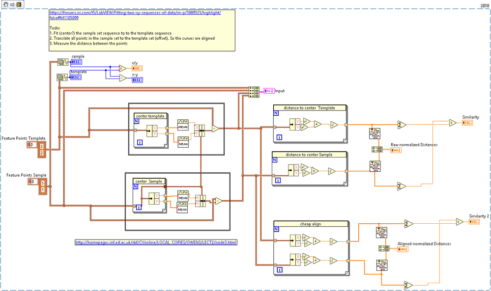

 for both datasets, separately:
attached converted to a 2014 .vi

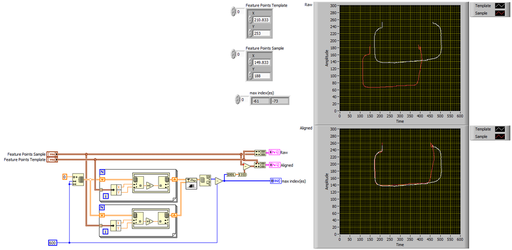

So the length of such an vector would be what I named "distance"
Message 8 of 16
(4,283 Views)
@alexderjuengere wrote:
Interesting idea to do a cross-correlation with the derived 1d arrays!
Of course you could map the data into 2D arrays and do a 2D cross correlation directly. 😉
Message 9 of 16
(4,270 Views)
Note that my solution gives great fidelity in the entire left 80% where the curves are very similar and ignores the right side where they differ in shape. This is probably desired behavior. 🙂
Message 10 of 16
(4,266 Views)
