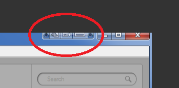

What's that overlay adding these weird buttons on the upper right of the window? can you disable that? This is not standard and could interfere.

I will disable NVIEW from Nvidia and try. That is the extra buttons you see.

Yes, NView is probably the problem. There are several issues with LabVIEW and NView.
Your problem and a solution is described here. You can also turn it off for LabVIEW only, see the last post here.
