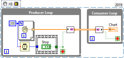

Here's a simple Producer/Consumer design.  The Producer generates 200 random numbers every 200 msec (or 5 times/sec).  As fast as the data come in, they are "exported" out of the Producer Loop into a neighboring Consumer Loop for further process (which might take additional time, such as doing an FFT, opening and writing files, etc.), leaving the Producer to chug along unimpeded.
I've chosen to use Asychronous Channel Wires (introduced in LabVIEW 2016) as I find it an easier "metaphor" than a Queue for shuttling data between parallel loops.  The rectangle originating the "orange pipe" is a Stream Channel Writer, which accepts data (in this case, an array of Dbls, hence the orange color of the Channel Wire).  The Stream Writer has an additional Input, "last element?", that has the Stop button wired to it, allowing it to tell the Consumer, containing its Stream Reader, that no more data are coming, and allowing the Consumer to stop.
For Extra Credit, why did I put a Frame Sequence (which I almost never use) around the Stop Button?  If you aren't certain, try wiring 2000 into the For loop, slowing the loop way down to every 2 seconds, run (and stop) the loop several times, then remove the frame and do it again.  To understand what (any why it) is happening, think about the Principle of Data Flow.

Hey Bob! I tried what you sent over and this is great!! Super helpful stuff and very easy to understand, I'm gonna restart my VI from scratch and I'll try to implement these system.
I think I got the question right but just want to check one thing, I know it might sound basic but: the miliseconds timer value is wired to the FS so for example, if I press the stop and there is still 1 second remaining out of the 2 total, it waits, sends/plots data and only then does it allow an exit right?
Thanks once again!

Glad you like the Channel Wire demo.  I'm not sure you got the Frame-sequence question.  Let me phrase it another way --
Make a While loop that has a 10-second Wait (wire 10000 to it) inside.   Start it, push Stop at any time, and guess how long it will take to finish.  I'll trust you in this, but here's a bet -- you pay me 10 cents if it takes more than 9.9 seconds to finish, and I'll pay you $1 if it finishes before 9.9 seconds.  Run this 10 times, then donate the dollar you'll probably owe me to a Charity of your choice.  Why did this happen?
