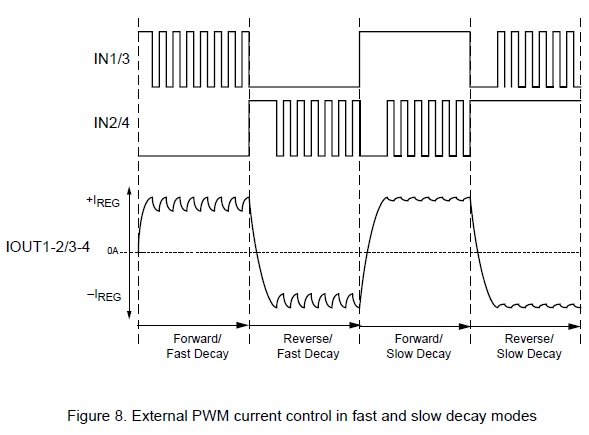

I need automation because I have to generate a pulse train that looks like the inputs 1,2,3,4 below:
so that the output gets generated in the osciloscope.
Basically, my question is how do you automate changing the duty cycle after, say, "x" milliseconds?
In case anybody is curious, I'm using Figure 8 from this data sheet

looking at the output ...there's capacitance on it. is that what you want or do you want a square wave instead?
Message 2 of 10
(5,588 Views)
I want to generate the square wave and feed it in as input to the motor.
That is the first step.
The next step will be to see if I actually get the output they have shown in Figure 8 on pg. 10 of the data sheet.

My goal is to put some measurements around the Figure 8's outputs (the wavey fast and slow decays).  Currently the data sheet does not provide them so I have to measure them myself using an oscilloscope.
Using the Complete PWM example counter code I can dynamically update the frequency and duty cycle using the front panel controls.
Looking at your suggestions I believe ultimately #2 will be what is needed to get the motor behaving the way we want, however we may need to do testing with #3 in order to figure out what is needed for #2.
