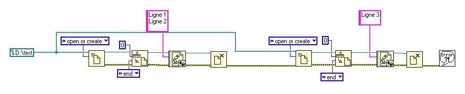

Hello, i have some problem with a very simple task : appending some new data to a file...
Why this test vi does not work ? i always get the "Line 1" overwritten by "Line 3".
Thanks for any help,
Vincent

Hi Vincent,
with your VI i got the following text :
Line 1
Line 2
Line 3
It that not what you want?

Hi Vincent,
can you upload you vi?
If i do what you show in your picture, then it works as expected.
Mike

Hello, happy to know that it's working for you...but on my pc (Windows XP and LabVIEW2009) i always get :
Ligne 3
Ligne 2
i really don't understand what can go wrong here ! it's just such an obvious task to do...

Oups, i've read your last reply too late : here's the vi !
Vincent

Hi Vincent,
plaese try this code. It works in LV8.6 and 2009.
Mike

Hi Vincent,
or you can try this VI written in LabVIEW 2009.
Regards
MY

well...this is kind of strange ! The vi you've just sent to me works perfectly, altough the diagram is almost similar. I then tried to re-write my vi from scratch, and now it's working too !!! Is my initial vi working on you computer ?
Vincent
Yes it is working fine.......

Interesting, now i have the same problem with your vi.
