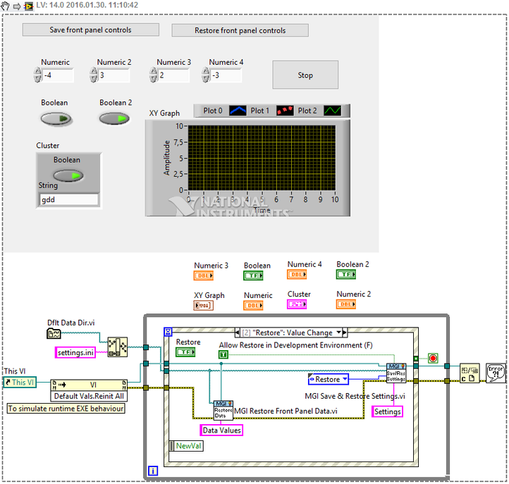

I have been seeking a simple way to save control values in the front panel
Do not reinvent the wheel, when there are ready to use solutions, for example:
https://www.ni.com/en/support/downloads/tools-network/download.reusable-vi-library-for-labview.html
Use the MGI Save & Restore Settings VI from the palette (for example it saves all settings modified in a Graph, very useful), and the MGI Save (Restore) Front Panel Data VIs (to save and restore control values in the Front Panel).
Here is an example:
Message 4 of 10
