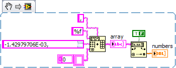

Hi OnlyOne,
easy like this:
20223i6E806FBE09F9FDFD
Message 2 of 12
(26,951 Views)
Thx for the fast answer but its not working corectly.
The numbers are wrong converted:
For example a:
+2.93120677E-03 is converted to 2 instead of 0,00293120677
Whats wrong here?
Message 3 of 12
(26,935 Views)
Accepted by topic author OnlyOne
Hi OnlyOne,
you should note that you configured your computer wrongly Smiley Wink You use German/East Europe regional settings with "," as decimal separator and try to convert measurement data using "." instead...
Well, try a format string of "%.;%f" - and read the help for format strings!
When the different format string also fails, you may try this one:
20225iC85653BA6FBF7EF9
Message 4 of 12
(26,932 Views)
Thx for the solution. Both things are working.
