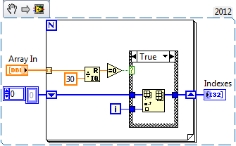

What i understood from your previous post i made a VI
Refer this and modify for your requirement.

Hi ManLD,
Your attached Vi give my required output but it's also giving zero for unrequired data but i don't want zero output for unrequired data.
Please advise
Message 9 of 28
