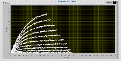

I'm trying to do a curve tracer with Labview, so after measuring the I/V curve I get a curve with a lot of points around a specific curve like the following one.
So I'm trying to do an average of those points and represent the curve like they normally do in some professional curve tracers.

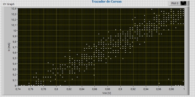

Another aproximation I can see is that, if I zoom a specific interval of the curve, there is multiple points which share the same X coordinate although not the same Y coordinate. Like the following figure:
So Im thinking about doing the average of those points with the same X and diferent Y because i guess its easier?
So any suggestions to solve this?
Why do you have ALL points in just one plot?
Why don't you create 10 (or 11) plots for the different traces in your image?
Separating those traces would make it a lot easier to filter the data…

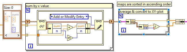

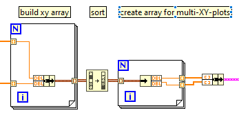

Your data looks like one line from the voltage file corresponds to one line of the current file. So read both files with Read Delimited Spreadsheet and loop over both arrays. In the loop, build an array of clusters to sort the data.
For averaging and in your special case of multiple exact x-values, you can group by x-value and do an average.
If you have LV2019, you can use Maps with the x-value as key and a {sum, counter} cluster as value.

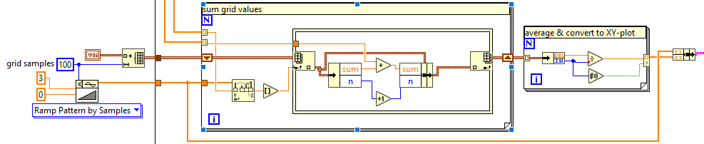

In earlier versions, or if you want a different grid, you could define an array of x-values and find for each input x the closest grid point. This is an example with a custom grid, you can swap it out against the sorted and deduplicated input x-values.
You should probably also filter out NaN values and ensure that every line has the same number of measurements.

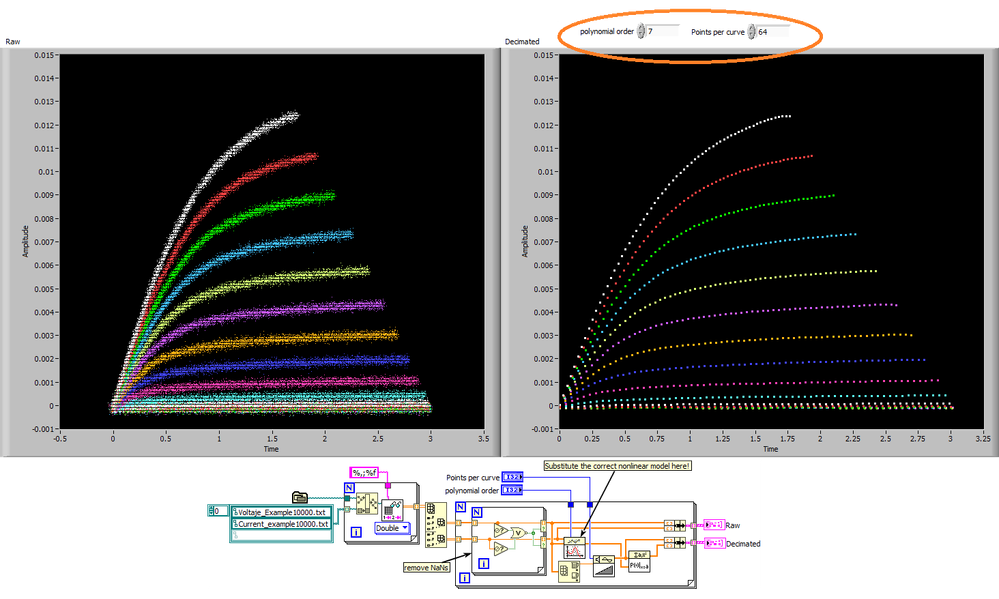

These curves seem to follow some simple mathematical model. If you have a formula, I would just do a nonlinear fit. This way you can reduce each curve to a handful of parameters.
Else, you could just some some filtering followed by decimation.
Message 6 of 14
(2,413 Views)
Here's using a dumb polynomial, but I am sure you can find a reasonable model equation. Depending on what each trace means, you could even do a 2D fit to all data!
(Note that the data files need to be located next to the VI, but you can of course modify that)

Cordm's solution looks amazing but I don't really understand your data flow.
What are the inputs for the sum_grid_values? And the cluster of arrays you introduce in Inicialize array is the sorted and deduplicated X values? And the other 2 inputs? Can I have a look of the vi?
