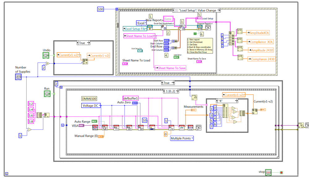

I started this conversation in another thread but this is not the same topic, so here's the new question. I was told that I was using too many local variable but I don't know how to get rid of them. Here's the updated code with some other fixes. This code works great butif I'm doing something wrong I'd like to fix it.

For some things it is OK to use local variables, like if you only care about the most recent value in a control and it is ok to miss some of the values in between. But, other times when the expected value and the actual value are different you have a race condition. And when the expected value and actual value are only sometimes different you have a race condition that is hard to track down.
It is also a little awkward to have an event structure side-by-side those case structures which are triggered by booleans. The event structure is very good at detecting a boolean value change, so you should put those inside the event structure, and then you not have to make the event structure timeout every 100ms. Also, make some SubVIs that perform a well-defined function, like taking your instrument measurement. Then your code can fit on one screen and you won't have to use the stacked sequence structure.

I would restructure this as a Queued Message Handler:
Two parallel loops:
One with an event handler, generating messages,
the other processing the messages.
Store data in shift registers.
Inside your event structure, there is a sequence frame; it's doing nothing, get rid of it.
The 2 local variables for "Sheet Name to load" & "Excel Setup File" are unnecessary because you have the control terminals right there; use them.

Good morning guys. I'm reading your posts and trying to implement your suggestions. Thank you very much for helping me BTW.

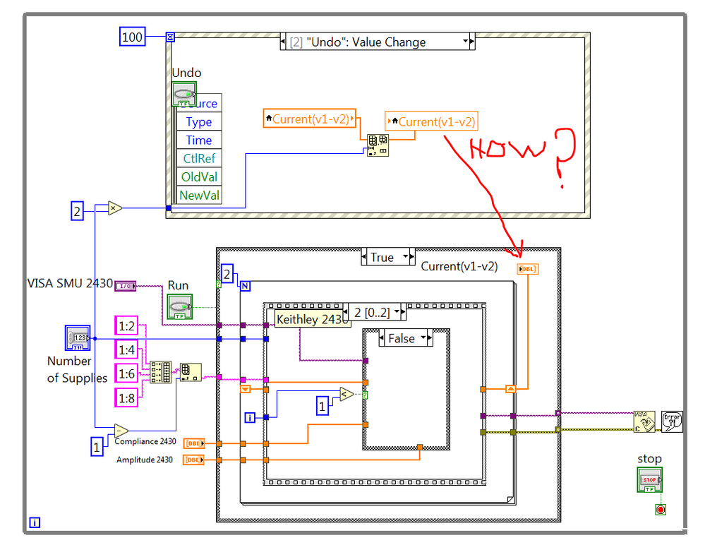

I got rid of the unused flat sequence and added the undo into the event structure. Turning portions of this into sub vi's is next unless you see something else. In the stacked structure I want to change the 1[0..2] portion into a subvi. The issue is with that local variable. How can I accomplish this? I have all day to work on this so I'd appreciate it if you could try to walk me through this a step at a time until it looks and work on a professional level. Let's go!

If you are basing it on a local variable of the current diagram, when you create the subVI, the value from the local variable (or terminal, or wire from somewhere else in the code) will pass into the subVI via the connector panel.
If the local variable is included in the selection window when you highlight the code and pick Edit >> Create subVI, you'll see it turns it into a reference of that boolean control, and places an explicit value property node inside the subVI.
Instead, if you move the local variable to a position so it is not included in the region you select, basically the boundary of the selection region crosses over the wire coming from the local variable, you'll see it creates a control in the subVI that is put on the connector panel and the local variable in your main VI will attach to that connector in the new subVI.
