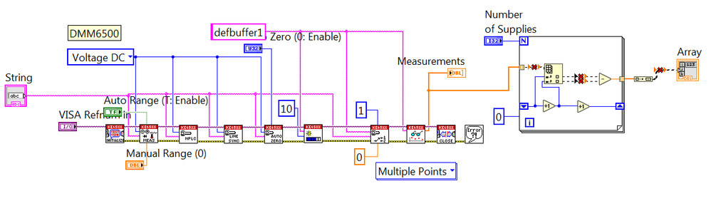

How to illiminate some local variables
That didn't work.

@RHutchings wrote:
That didn't work.
Because you didn't do what I coded.  Turn off indexing on the array input.  And remove the Build Array function on the outside of the loop.

@RHutchings wrote:
Thanks. That's what I did. Here's where I'm at after making some sub vi's.
As I said, all lower code should be in its own event case, with a 1D array running through all cases, getting data added or removed depending on the event.

"Because you didn't do what I coded.  Turn off indexing on the array input.  And remove the Build Array function on the outside of the loop.  "
Done and it works great! Thank you.

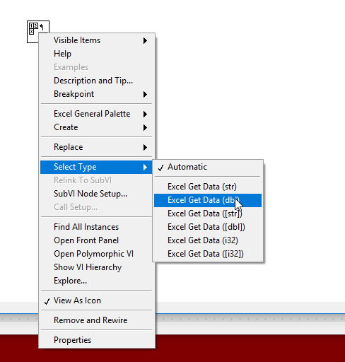

"If you must use the RGT to retrieve values from an XLS file, set the datatype on the Excel Get Data to be an array of doubles.  No post-import conversion would be required on your part."
How?

gregoryj,
Your mouse is over the dbl value but the OP needs the [dbl] selection (array of doubles).

Message 19 of 43
(2,078 Views)
Oops, I don't use that function and I figured it was like reading a delimited spreadsheet where all the data is in arrays. Good catch!
