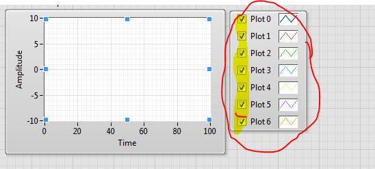

And, Setting Plot visibility that way is just plain silly.
Right-click the Plot Legend and expand Visible Items check the "Plot Visibility Checkbox"
(4,163 Views)
Thanks for that information, Jeff·Þ·Bohrer. I am still new to LabView and did not know that the plot visibility was available by simply right clicking.

Jeff·Þ·Bohrer,
I don't think that many are aware of the right click for plot visibility feature, as I got the idea that you've called "silly" from a forum post, "how do I display multiple plots on one chart?" The attached referenced vi that I've used was from altenbach, KNIGHT OF NI. Thanks for educating myself and others on this feature though.
