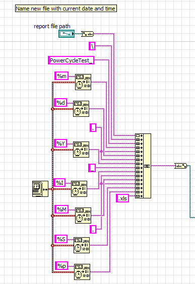

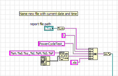

On a side note do this.
Not this
=== Engineer Ambiguously ===
Message 3 of 16
(5,764 Views)

Better yet, build the file name using a single format to string node and use a conventional build path to add it to the path.
Mike...

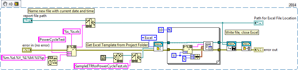

This snippet encapsulates most of the previous suggestions, and adds a few of my own.
The first code shows one (simplified) way of building the output file name.  It incorporates the Build Path function to combine Report File Path with the file name (don't need initial "\"), builds the File Name with Format into String, getting the Time part of the name from Format Date/Time String.  I also use Build Path to get the Template path.  Inside the For Loop, another Format into String gets the data that is placed in the 10 Excel cells.  We don't write anything yet -- we're only filling in the cells in the WorkSheet (think of how you use Excel -- you could, but probably don't, save the WorkBook after every cell entry, you wait until you are all done and then do a Save, followed by closing Excel).  Finally, when we are done, we save the file using the output name we want to use, then close Excel (which disposes of the Report Object).  If we want to generate another report, with another (time-based) name, we can put this code into a sub-VI and simply call it again.
Don't worry if you don't have LabVIEW 2014 (which was used to save this snippet) -- most of the code comes from the original that you posted, so it should be a pretty simple edit to change that code to match this.
Bob Schor
Message 6 of 16
(5,700 Views)
You know you can wire a timestamp to a format to string and move the time formatting into the format string.
Mike...
