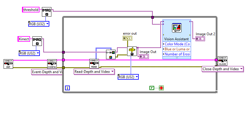

Can you please post your solution? I have the same problem when using Kinesthesia and NI Vision. I tried multiple fixes and still get the same error when converting from Array 24U to IMAQ Image.

FYI, I solved the problem using an adittional IMAQ create for the VIssion Assistant Dst input.
