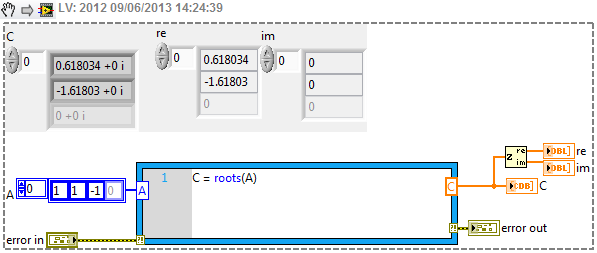

How to use Mathscript command 'roots' to find the 2 roots of x^2+x-1=0. Quadratic formula yields x= 0.618 and x= -1.618.

http://zone.ni.com/reference/en-XX/help/373123C-01/lvtextmath/msfunc_roots/

Thanks for your help!
