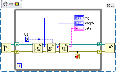

Hi guru,
as said before:
- Use FileRead function to read the tag (byte) and the length (byte).
- Then read the value bytes (given by length) and parse it (information given by tag).
- Then continue with reading next tag and length...
Simplified example:
Message 9 of 13
(6,757 Views)
Dear GerdW,
Thank you so much for sharing sample VI.
I checked your VI with my sample file But, I'm not getting proper data.
I want to read CAN Frame (i.e. Timestamp ID and Payload) data from this file.
