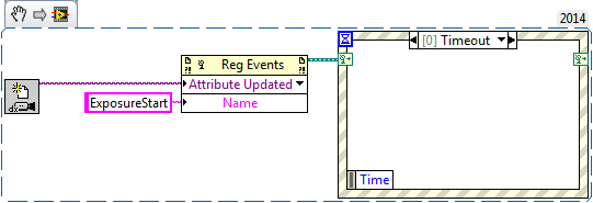

I am not entirely sure if what you are trying to achieve is possible. The closest thing I could come up with in LabVIEW is the following. It monitors for camera attributes to change and if they do change it passes a True boolean which you can use to control LabVIEW functions.
