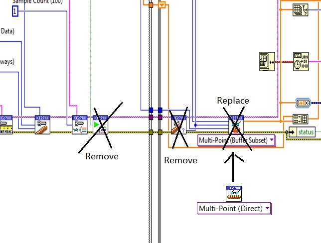

Replace "Read Data Buffer Subset.vi" by "Read Multiple Direct.vi".
"This VI initiates a reading, waits until data is available, and returns that data.  The data is output directly to the bus instead of storing the data in the instruments internal data buffer."

I want to use my Keithley 2750 with a 7703 to obtain a maximum channels/second. In this moment I am using a .vi with a "Read Multiple Direct.vi" (please see the attachment), but I can only read 37 channels / second.
Thats why I want to use the "Read Data Buffer Subset.vi", with this I expected to obtain an improvment.
Many thanks.

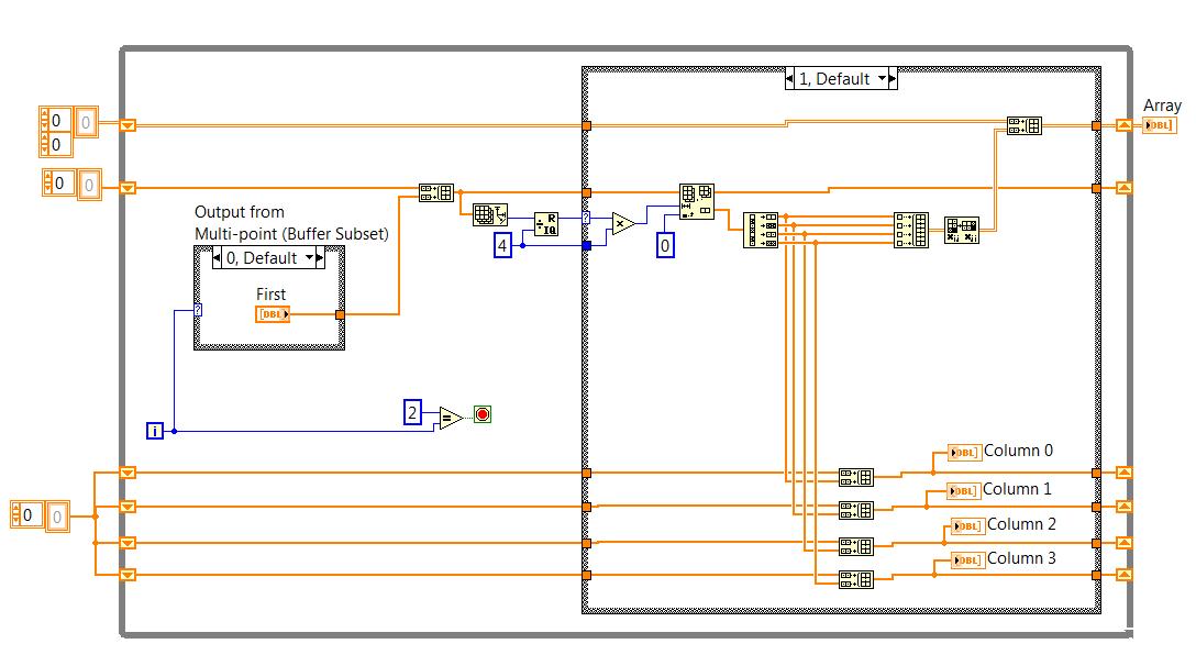

I am not familiar with the express vi "Write to Measurement File", but you could separate yours data like this:
It seems for me than you could read about producer - consumer:
