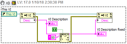

Just in case someone else encounters this, here is a code snippet that fixes the issue.
Paste it into your VI, run once, then save the VI.VI Documentation cleanup.png
