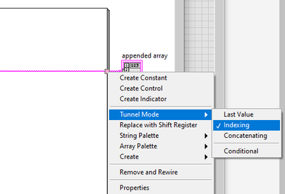

It's because you have the "last element" terminal on the output of your for loop. You should change it to "indexing".

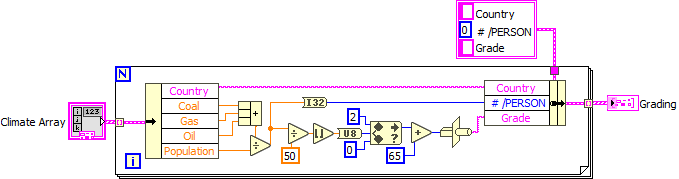

See if this can give you some ideas. (just a picture, so try to implement it. A good exercise). Note: No case structure! (Some things can be simplified, but start with that)

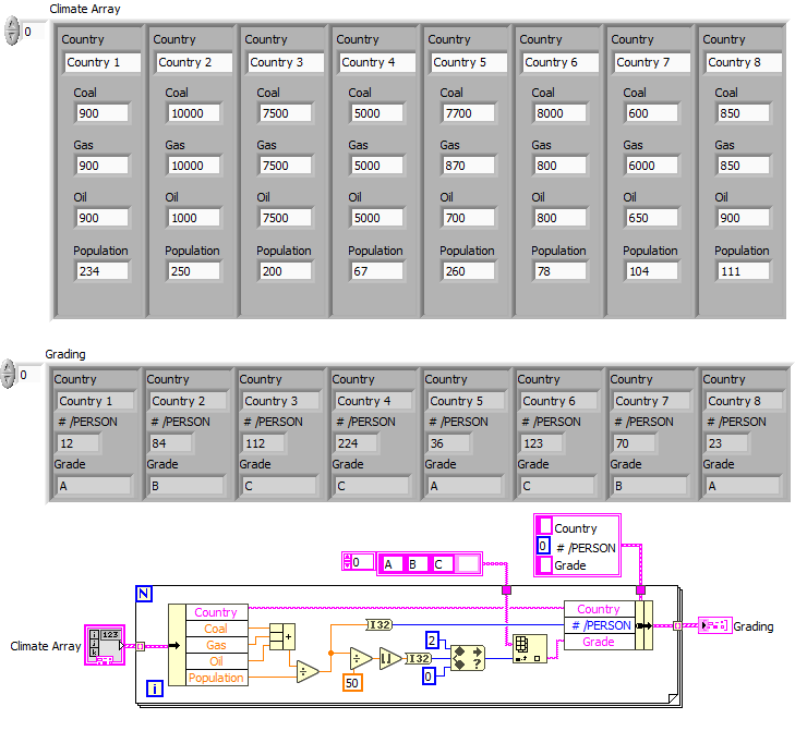

This gives the same result but is a bit more obscure. Try to figure out how it works 😄
