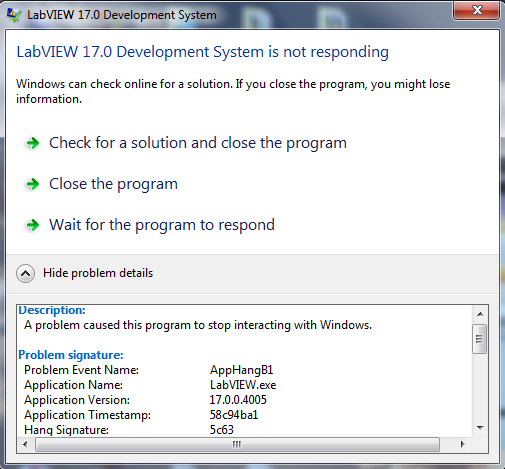

LabVIEW 17.0 Development system is not responding to windows
Description:
A problem caused this program to stop interacting with Windows.
Problem signature:
Problem Event Name: AppHangB1
Application Name: LabVIEW.exe
Application Version: 17.0.0.4005
Application Timestamp: 58c94ba1
Hang Signature: 5c63
Hang Type: 262144
OS Version: 6.1.7601.2.1.0.256.1
Locale ID: 1033
Additional Hang Signature 1: 5c635adb49dbedca25c3bb8c63f473f2
Additional Hang Signature 2: 849d
Additional Hang Signature 3: 849df68c870eac6b70b5381140f8383f
Additional Hang Signature 4: 5c63
Additional Hang Signature 5: 5c635adb49dbedca25c3bb8c63f473f2
Additional Hang Signature 6: 849d
Additional Hang Signature 7: 849df68c870eac6b70b5381140f8383f
Software Details: LabVIEW Full Development System  version 2017
NI Hardware:  None
Operating System:  Windows Capture.PNG

Is it reproducible or did this happen only once?
Is there anything wrong with the VI (Excessive memory use, etc.)
Message 2 of 24
(6,881 Views)
It is reproducible occuring every time i run LabVIEW software on my pc, but it was running fine earlier when i installed LabVIEW first on my PC
Message 3 of 24
(6,878 Views)
Do you mean it happens if you just start LabVIEW in edit mode or does it happen once you load or run a VI?
Message 4 of 24
(6,870 Views)
This is happening at time i double click to open LabVIEW and hence not able see or work on new blank VI
Message 5 of 24
(6,868 Views)
Accepted by topic author NareshKumarLega
What else changed on your PC since it worked last? (system updates, av updates, new security software, other software, etc.)
Have you tried to repair the LabVIEW installation?
Message 6 of 24
(6,845 Views)
I have done no changes nor any updates done on windows and antivirus. Firstly i installed LabVIEW 32bit with 7 days evaluation period. After installing i have worked on LabVIEW and made program. But after 4-5 days when  i again tried to open LabVIEW then it start causing this issue of not responding. Then uninstall and reinstall LabVIEW. Then i even activate using student edition of LabVIEW.
Message 7 of 24
(6,840 Views)
Of course the reason can be almost anything. However, in a similar case in the past (LV 2011), I simply let the program to stay overnight. The day after, I found that LabVIEW could actually start and somehow removed whatever prevented it to load normally.
Another suggestion is to reset LabVIEW configuration to default by renaming LabVIEW.ini before launching the program. LabVIEW ini file is in the same folder of LabVIEW.exe. This is a very quick test to do.
Paolo
LV 7.1, 2011, 2017, 2019, 2021
Message 8 of 24
(6,834 Views)
Can you please elaborate your solution step by step how to implement them. I am getting how to reset LabVIEW configuration to default by renaming LabVIEW.ini before launching the program.
Message 9 of 24
(6,801 Views)
It's very simple. Go to \Program Files (x86)\LabVIEW 2017 (\Program Files\LabVIEW 2017 if you installed the 64 bit version).
Rename LabVIEW.ini to LabVIEW1.ini  (or anything else). Launch LabVIEW - which will now start with default settings - and see what happens.
Probably nothing different than before. However, if you are lucky and some LV settings was causing the hang, you will have the chance to start over; then you would need to figure out which is the offending setting.
If this doesn't solve the problem, rename LabVIEW1.ini back to LabVIEW.ini before going on.
Paolo
Message 10 of 24
