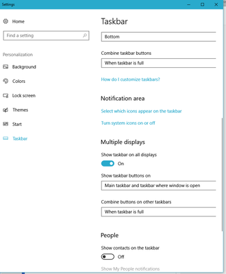

I have never heard of this behavior in Windows before.  I have 2 monitors with the desktop extended across them.  No matter which monitor a window is open on, the window shows up on both task bars.  On my primary monitor it is the wider buttons that show all or part of the window name.  The secondary monitor shows all the same windows, but shows them in small size without the titles.  If I move a window from one monitor to the other, nothing about the appearance of either taskbar changes  This is all in Windows 10.
Do you have different settings on your monitor arrangements?
EDIT:
I just googled and discovered this.  https://superuser.com/questions/1162515/show-corresponding-icons-for-each-monitor-on-task-bar
Apparently default options pretty much give me the everything on both taskbars.  I never saw these other options because they disappear off the bottom of the taskbar settings page.
And these stupid flat styles that everyone is going to nowadays, the scrollbar that is on the side (a skinny grey line) is so non-obvious I had no idea there were twice as many settings.
Capture
