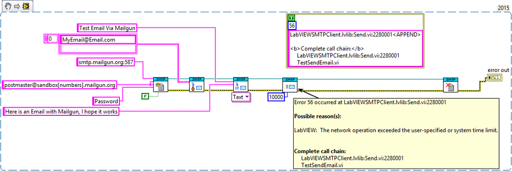

I'm trying to use LabVIEW's SMTP Email Palate To send an Email from my Vi to my Email. My Code Snippet looks like this:
Current Code With ErrorCurrent Code With Error

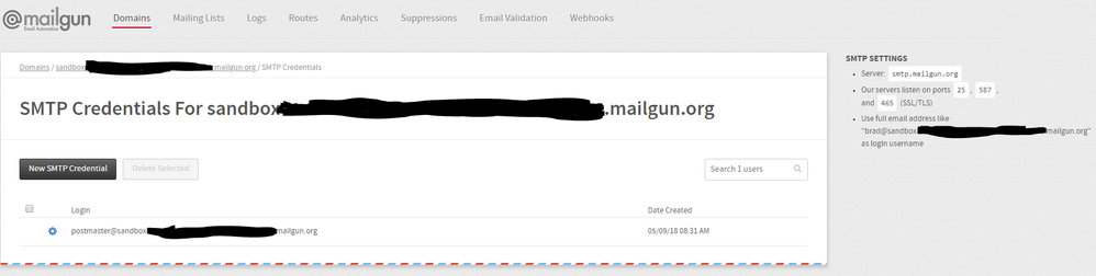

From What I can tell Via The Mailgun settings:

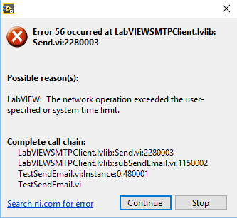

I've tried the same settings with GMAIL.vi as well and I ran into the same timeout error. What can I do to fix this process?

Hey, I've looked into the page and have tried sending a test email without any luck. (Still getting a timeout error)
Could there be something else getting in the way?
