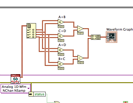

Fair enough. I am using a quad photo diode to isolate the horizontal and vertical motion of a laser. To that end, I am inputting 4 separate signals into the LabView VI that I am working with. What I would like out of the VI is an oscilloscope that is capable of adding four signals together so that there is one output wave rather than the four separate waves that I am currently getting.

Add and Subtract from the Numeric palette work on waveforms.  Is this what you wanted to know how to do?
Lynn

Wonderful. Thank you very much; clearly many Kudos are in order.
