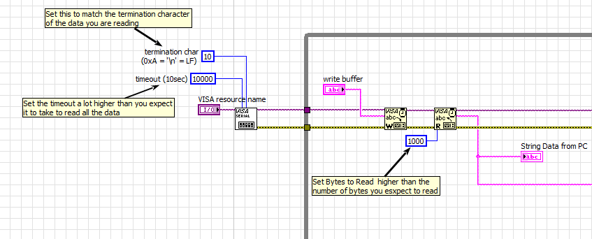

@cgarlow wrote:
it has a carriage return, looks like a musical note
Well then lucky for you this is going to be somewhat easy...
Ignore the VISA Write in this example as you don't need it.
The VISA Read will read data until it receives a Termination Character or times out.
=== Engineer Ambiguously ===
Message 8 of 16
(8,699 Views)
Ok, now that I have enough information...
This instrument sends data as ASCII and properly ends the data with a termination character (the Carriage Return).  Also from the screen shot, I know all of the serial port settings.  And the last important bit of information is that this is what I call an "intermittent transmitter," meaning it sends data at non-periodic rates (in this case, when you push the in/mm button).
So this is what you need.  Use the Bytes At Port to see if any data has come in.  We are not using that to see how many bytes to read, just to verify that a message has at least started.  If there is no data, wait (I used 50ms).  If there is data, just use VISA Read to tell it to read more bytes than a message will ever be (I just used the same 50 constant).  This works because the VISA Read will stop when it reads the termination character (the Carriage Return).  With that string, just use the Fract/Exp String To Number to get your latest reading.
NOTE:  The "..0" case has a Wait (ms) using the same 50 constant from outside of the case structure and the VISA Resource and Error wires are just passed through.
