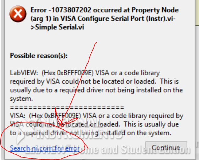

VISA 17 would work with LV 16.
There is no VISA 5.8, so I don't know where you got that from looking through your installed programs.
Your MAX shows NI-VISA 17 installed.  Also LV 16 32-bit and 64-bit.  I think the problem is that you are using LV 2016 64-bit because your LabVIEW icon is white.  That means you don't have the 64-bit version of the VISA drivers installed.
is there any reason you are using 64-bit?  You should be using 32-bit unless you have special needs like using lots of memory for vision applications
Try starting LV 32-bit and run your VI.

Just out of curiosity.  (I hate asking this but...) did you consider following the hyperlink shown in your picture?
Here it is
See the Link?See the Link?
Did you install VISA support for LabVIEW 64 bit?  Doe it work for 32 bit?
