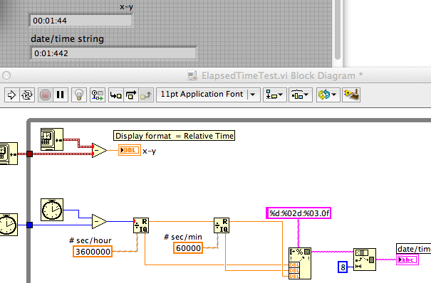

The reason you are not seeing the right number is that the value you get out of the last Quotient & Remainder Function is NOT the seconds, but MILIseconds.
Add one more Quotient & Remainder with a 1000 as y. Then take the floor(x/y) as your seconds.

If you do not need a string output, consider subtracting timestamps and formatting the numeric display of the difference as Relative Time.
Lynn

Thanks dkfire,
It works great!
frn
(3,377 Views)
Thanks Lynn for your input, but I need string as an output.
