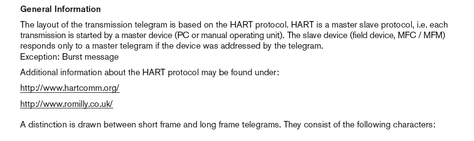

Here is what the manual says.
This would indicate to me that you have to talk to the device and get a responce.
Tim

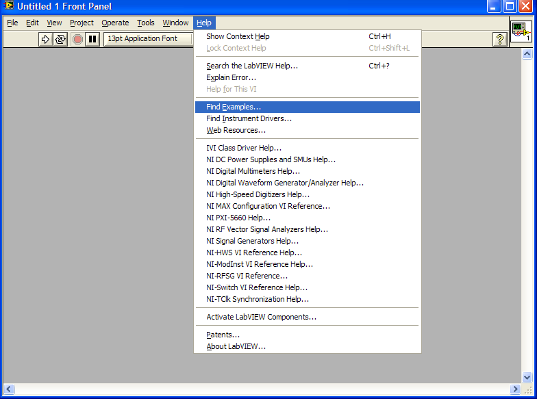

NI has an example in the serial communication. If you go to help see attached: I do this as you may not be in the same version of LabVIEW and it is good for you to find these things yourself so that you how to do it in the future.
Then select the search function and type serail and hit enter select the serial and the examples are right there.
Let me know how this works for you.
Tim
