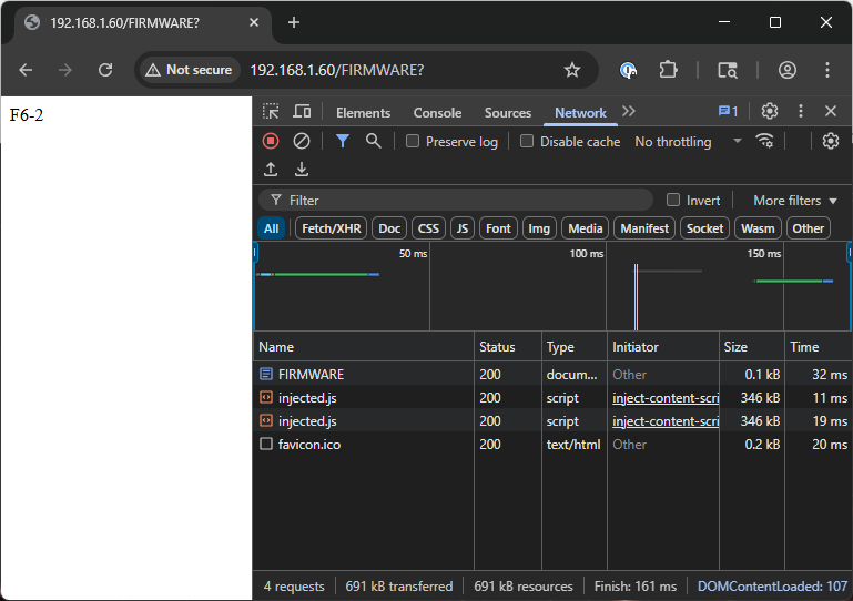

Trying to implement LabVIEW drivers for this switch using HTTP communication. To get started I'm trying to implement a firmware version check, the example is "http://10.10.10.10/FIRMWARE?" and my device is at 192.168.1.60 so http://192.168.1.60/FIRMWARE? is my URL. When I go to this URL in Chrome I get back the expected version string.
I can also do "Invoke-WebRequest -Uri "http://192.168.1.60/FIRMWARE?" in PowerShell which returns "F6-2" in the content.

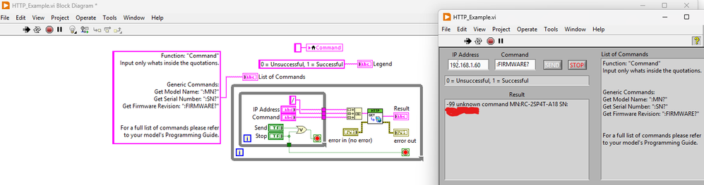

For the life of me I can't get the LabVIEW HTTP client to give me back this same string, I always get back "-99 unknown command MN:RC-2SP4T-A18 SN:<redacted>" in the body. I used the chrome dev tools to exactly replicate the headers used in its request but nothing changes this response.

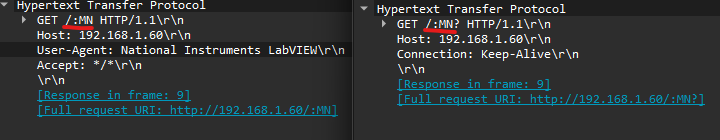

After playing "spot the difference" with Wireshark for a bit I found the important one: for some reason the LabVIEW client is stripping off the ? at the end of my request URL:

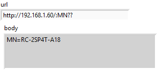

Adding an extra one made the instrument understand the request:
Playing around further showed apparently adding any character after the '?' fixes the issue. So I think I have a valid workaround.
