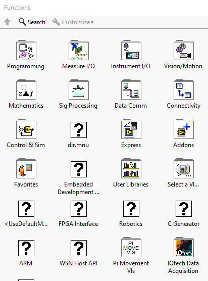

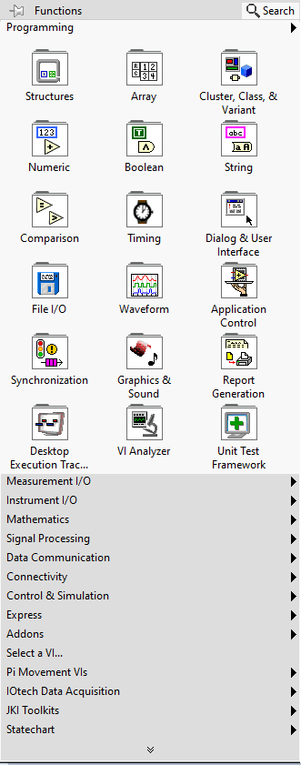

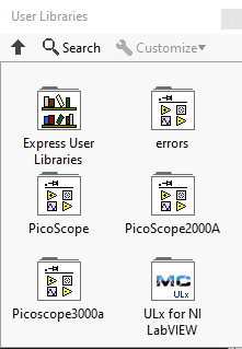

I'm currently moving everything over to my new computer and I have everything done except for some LabVIEW things. Getting my function palette correct is one of these. I was able to copy over other custom tabs, but the user library does not show up. Is there something I am missing as to why it will show up under the settings, but then not in the program?

Well I was dumb. It was there and just hidden. When I clicked the down arrow it was there and was just not enabled to be visible.
