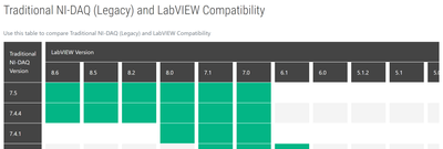

While I am at it, I have been wondering about an elusive NI-DAQ (Legacy) version, 7.5 :
https://www.ni.com/en/support/documentation/compatibility/17/traditional-ni-daq--legacy--and-labview...
All the NI-DAQmx versions of that time accepted the presence of the NI-DAQ 7.4.4f5 version.
So why list a version 7.5, nowhere to be found ?
That was only really "released" as a preliminary beta release. Supposedly to be released as a full version but then abandoned as all the effort was put entirely into DAQmx.
https://download.ni.com/#support/daq/pc/ni-daq/traditional/7.5-Beta/
There also was a DAQmx 7.5 version: https://download.ni.com/#support/daq/pc/ni-daq/daqmx/7.5/
