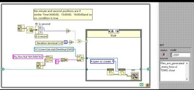

I don't understand what you mean. I once tried to keep the TDMS file reference in a shift register, but it didn't work, so I don't know how to use the shift register correctly in my vi program?

Hi lai,
This is a simple sketch:
You need to add proper initialization and error handling…

 Thank you for your reply, but there is an error in the vi program

Hi Lai,
there is an uninitialized output tunnel.
My snippet shows how to handle that correctly!

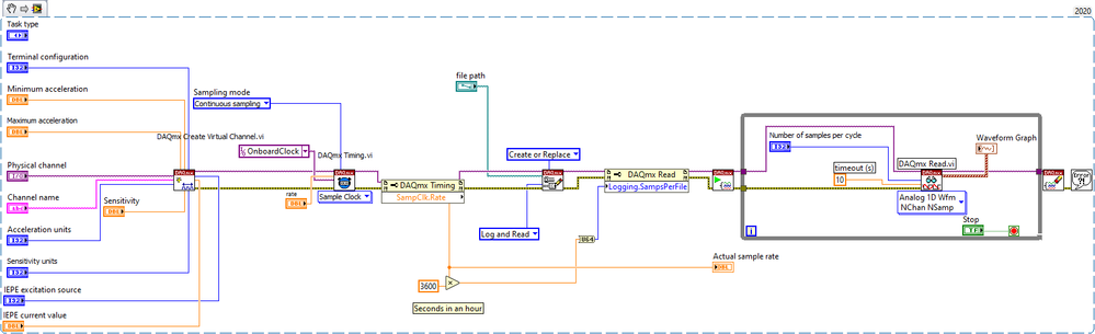

Much easier way to do this.
  1. Use the built in logging features of DAQmx.
  2. Use your sample rate times 3600 (seconds in an hour) to tell DAQmx logging how big you want each file.
  3. Every hour from your acquisition start DAQmx will start a new file. (Test it by changing 3600 to 10, you will see a new file every 10 seconds)
Message 8 of 21

Due to jet lag, did not reply in time, thank you very much for your help, this is really great, I have some additional questions, I hope you can get the answer, may I first click on the VI program run button, vI program running for a period of time after clicking the VI program abort button, a total of 10 files generated. A second click on the VI program's run button will not overwrite the previous 10 files, but will continue to generate new files after the first 10 files
