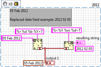

Index out the column
Format to timestamp
format back to string
replace column

not exactly but a minor mod to the format specifiers would
That does it

Would you mind posting the vi, as the functions are not immediately familiar?

Check the edit above.  It took a minute

Harry,
Jeff's picture is a code snippet.  Drag the picture to your desktop and then drag it into a VI.  Voila.

That is cool. Thanks!!!

@aputman wrote:
Harry,
If you look at the edit time in the post it makes more sense.  I posted- ran off to whip up a quick example (Couldn't remember the difference between %B and %b) and was delayed with the edit crossing Harry's post-  so there was no example when he read it the first time.
(These things sometimes just need to be explained to make any sense)
