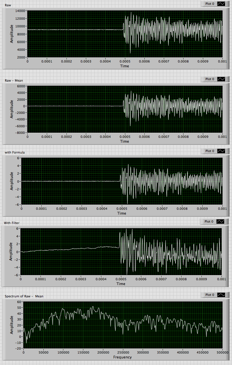

Munna,
The value you use in the filter formula only applies at one frequency, 1 MHz, because that is the value you entered into the formula. That appears to be the sampling frequency, not the frequency of any signal component.  For the formula to work you need to apply the value of the transfer function at EACH frequency to the magnitude of the signal component AT THAT frequency.
Your signal has a DC component which is ~30 dB larger than any AC component. That will create problems for the filter. The transient response of the filter probably lasts 5-20 ms, which is  far longer than your data set. When I subtract the mean before any other processing, things look more like what you might expect. It appears that your data has very little enegy below 30 kHz so I would not expect a lowpass filter at 100 Hz or 169 Hz to do much.
The image below shows the results after removing the mean. I also plotted the spectrum of the signal.
I do not see very much noise and I have no idea what you consider to be the signal in that data. Please describe in more detail what information you are trying to extract from the data.

Thank you so mcuh for your help.
In my project, I’m Injecting External Noise to DC Signal. Here External noise Generating by Two-way Switch.
This Noise Data with DC Signal displaying on DL850Scope. From scope I'm Reading this data (1000 samples).
So, Now I want to filter noise (based on Cutoff freq). After that I want to validate Filtered Data with Formula.
I hope this is clear for you.
Can you send VI of graphs which you posted.
