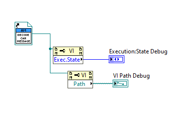

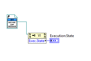

I am new at Labview, sorry...
This feature is very nice. But I think I might find my problem. I am trying to check if the new VI is opened in a new window, so I use something like the attached files.
When I am running under Labview, I get from "idle" to "tun top level". When I am using the executable i always get "bad".
Message 8 of 21
(4,092 Views)
So if I use something like this:
I can get access to the new VI, and don't get errors with the paths.
I will try to use this, approach. thank you
Message 9 of 21
(4,090 Views)
Using Static VI Reference solvess my problem. However, if I press the button to stop the app (the typical one), when I push-it it will stop the app, but the next time that I start running the program I cheking for the "VI > Exec.State" and get "Run top level". If I close the labview and perform everything by hand I get "idle". So my question is, how I can stop the new VI to be loading or something like that?
