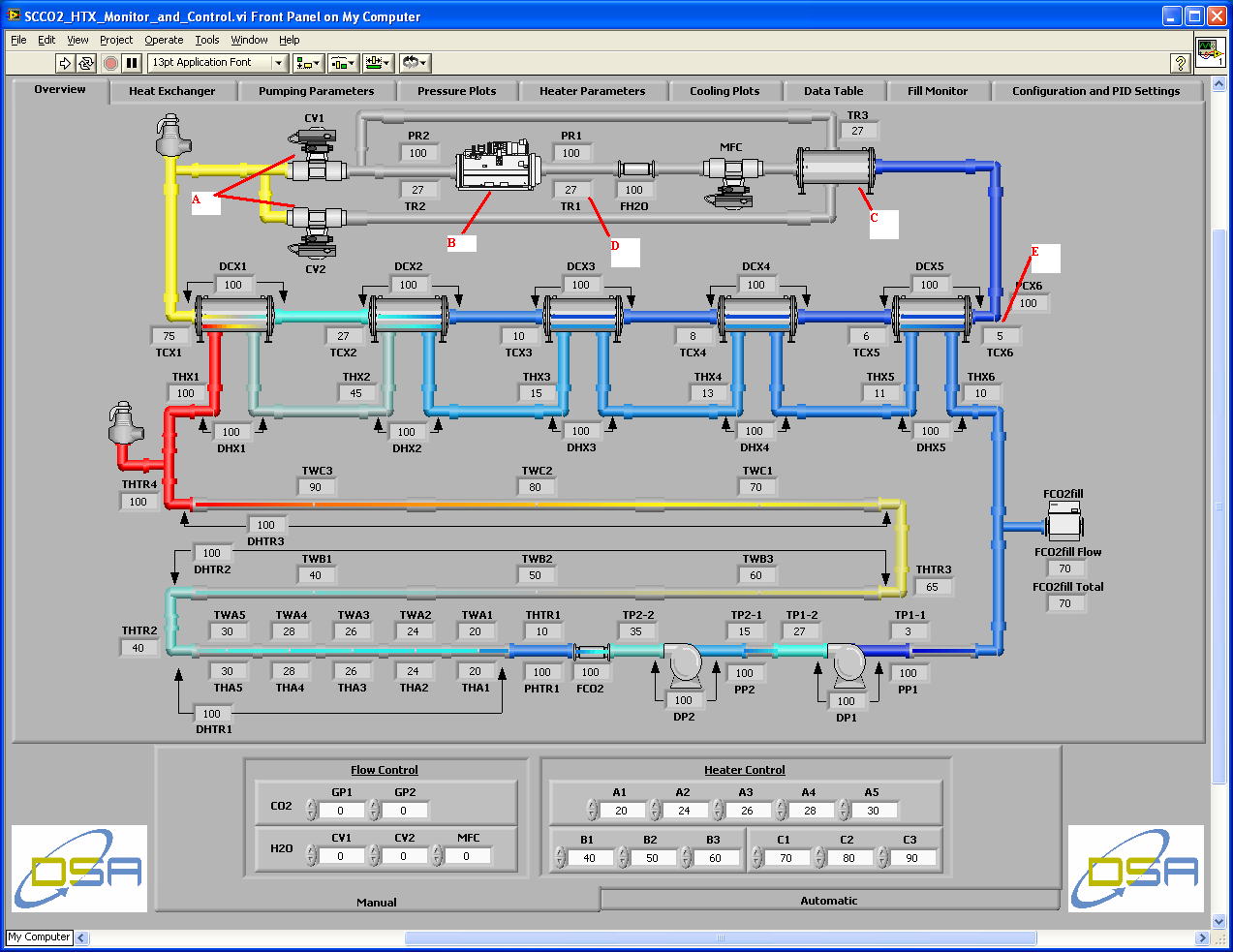

Here is the GUI Overview screen
A - Control valve pair
B - Chiller
C - Heat exchanger to warm up warm side of mix
D - Temp out of chiller
E - The temperature I have to regulate
What do you think?
Ben
Message Edited by Ben on 07-25-2008 10:54 AM
Message 4 of 9
(6,072 Views)
Wow Ben,
                   That defenitely is a colorful GUI.
Message 5 of 9
(6,062 Views)
Wow Ben,
You should see it in action. All of the colors ramps update live to illusttrate the temperature gradiants.
Ben
