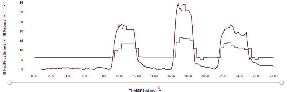

Problem: I have a force sensor (10 measurments/s @9600 Baudrate) and an arduino module - measures pressue (500,000 Baud rate) When I plot the two, I see as follows.
The force sensor has a low sampling rate as well as a low Baud rate hence the change compared to pressure is very slow.

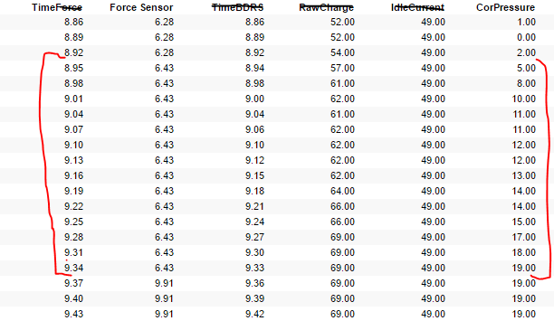

I also log them to a txt file. Below is a screenshot of the text file.
As you may see, for 0.39s, the force sensor doesn't change but the pressure changes over a span of 14 units. Notice the shift in time as well...
After data capturing, then I did a moving average of the pressure for 10 units. then I can almost get rid of the time shift and becomes smoother. (I also tried to up sample the force signal and interpolate)

Are you reading with 30 ms steps, and force sensor is giving the same value, or are you reading from it at 0.4s rate and just filling array to match the number of measurements of the faster one? In both cases it seems out of 0.1s spec, but on different reasons.

I'm on LV 2016 and can't open the code.  For the moment, I'm assuming it works like the advice I gave in prior threads where the two different serial interfaces provide data updates at different rates.  Hence, the slower one retains its prior value during several updates of the faster one.
To a certain extent, there is nothing to "solve" here.  You're simply seeing the visual representation of your system's actual latency.  The inherent problem of latency *is* that the moment you become aware of a sensor's value is NOT the same moment when it was actually true.  A sensor that reports its changes less often simply *will* appear to lag behind a related sensor that updates more often.
On the other hand, there are different factors that can lead to latency.  In some systems, the amount of latency is pretty consistent and can be characterized (though this is not always trivial to do).  When you can characterize it, then you can use this info to help "solve" the time-shift you observe.  You can shift the data in time (as already mentioned by Alexander_Sobolev), the key point being that you should first have *good justification* for doing so.
So in summary, I'd say that just fiddling with stats and algorithms to try to make things look like they line up is not really a good approach.  There should be more rationale behind what you're doing to your data.  Getting a faster-responding force sensor seems like a *much* more beneficial approach.  And further, whenever possible, I would try to avoid serial communication entirely and instead look to use analog sensors that can be captured with a data acq device.
