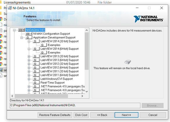

I've recently had to install LabVIEW 2014 64-bit to work on some old software. The software uses DAQmx subVIs but these wouldn't load because I had DAQmx 19.0 installed. I've uninstalled DAQmx 19.0 and tried to install DAQmx 14.1 instead. When I install 14.1 I get a couple of issues.
If I choose a custom install and try to select Application Development Support for LabVIEW 2014, it's greyed out and I can't choose it. Then, when I try start the installation I get the message that it won't install because it's incompatible with products already installed.

You seem to have mixed way too many incompatible versions of drivers and software and it can be very hard to unweave it piece by piece.  Go nuclear.  My first advice to to create a Virtual Machine to work in for this project and only install the version of LabVIEW and compatible drivers you need.  If that is not possible, the uninstall everything NI and only install LabVIEW 2014, DAQmx 14.1, and any other 14.x drivers you need.
