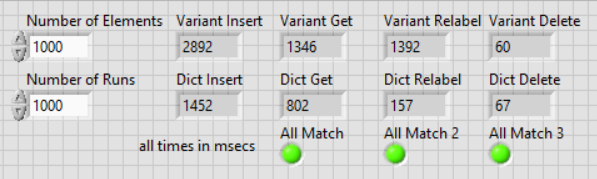

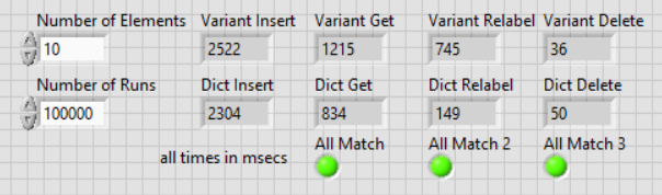

I missed having proper hash map dictionaries in LabVIEW and was not happy with the implementation from Bloomy so I implemented a proper dictionary in LabVIEW. Based mostly off of this wonderful talk from one of the core Python developers, it uses 4 arrays to track the keys, values, hashes and index map and 2 ints to keep track of how many elements there are and how many buckets are used in the index map.
On average, inserts and gets are much faster than variant attributes, relabels are orders of magnitude faster and deletes are a tad slower.
1000 elements
Try it out and see if you can squeeze any more performance out of it. I'm not super familiar with the intricacies of the LabVIEW compiler so I'm sure there is something I've overlooked performance-wise but it was pretty fun nonetheless and I'm quite happy with the results.

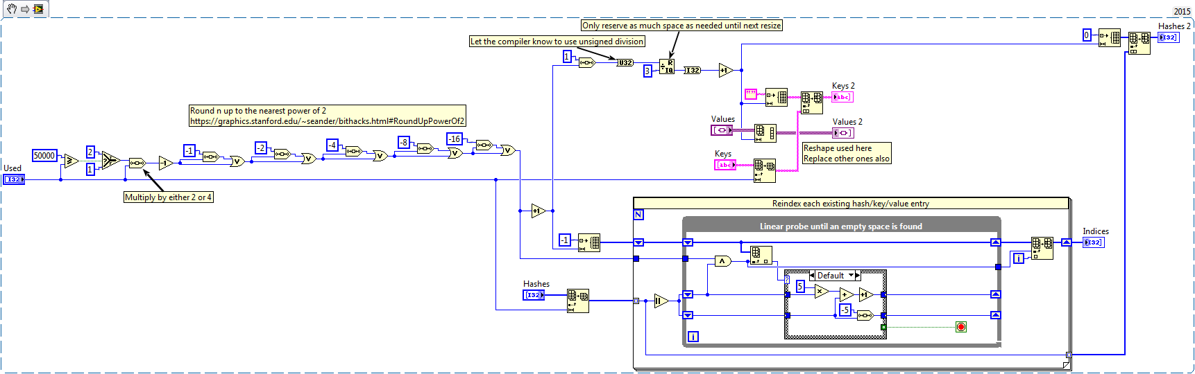

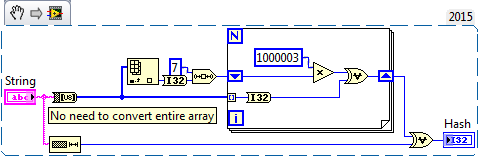

Here is some nitpicking, do not know if it will be useful. Your skill level is above mine.
1.) Unnecessary Buffer allocation in _hash.vi. You have a buffer allocation going from V8 to I32 which is unneeded. Convert to I32 for the element and in the loop, see below.
2.) For the _resize.vi you can try "reshaping" the array instead of making a new array and inserting the old values in. See below.
I have not tested any of these suggestions, so not sure if they are faster, better, etc.
