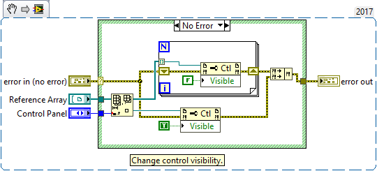

As a concrete example, in the Logging Volt case, under a True case, there is a case structure wired to what looks like a custom control Enum, or possibly radio button control, in which each case makes one control visible and hides 8 other controls. With an array of those 9 references, you could create a subVI which first uses 'Delete from Array' node to split based on the index, using the "Control Panel" value (make sure you have the references in the same order as the enum values!) and then a For loop to make 8 controls invisible, and a separate property node to make one property visible. An example is given below. The attached VI is backsaved to 2012.

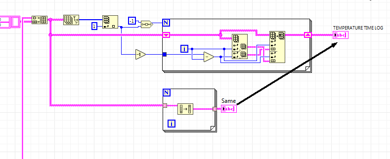

There are some fairly strange constructs in there.  My favorite so far is the darnedest reverse columns Iv'e ever seen
Which is slightly flawed in implementation.  had we shifted the decremented size we could avoid swapping the center column with itself!
