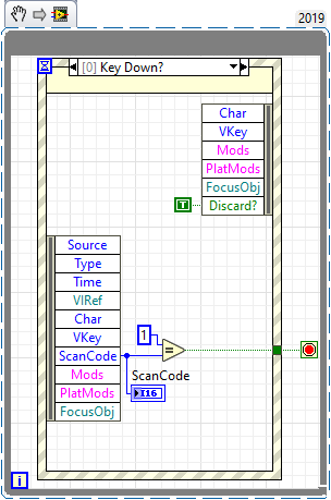

so, yes I split the thread to a new thread.   You want the ESC key to shut down a vi...... the best advice I can give you is to use a "Filter Event?" on a "Key Down?" and look for the scan code of ESC  Yeah, that would be a "1" on most keyboardsSmiley Wink
