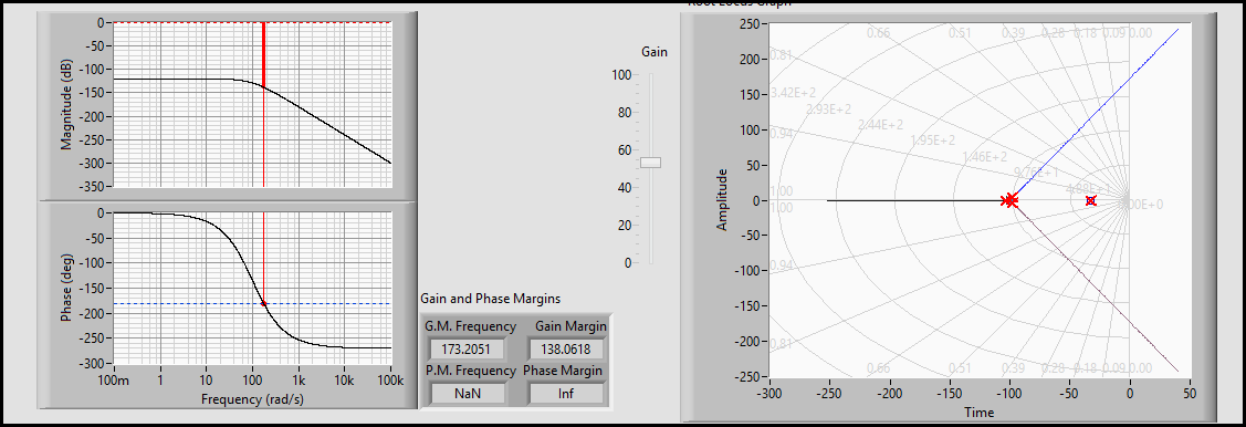

I just installed the 2013 trial version of LabVIEW and LabVIEW Control Design and Simulation Module. Normally, for control design I only use Matlab/Simulink but LabVIEW does have some advantages and I want to take these advantages. The problem I feel it is annoying is that I cannot use the Silver Controls to replace the default classis style control - like the bode gain and phase margin or root lotus plot below

Hi muahang,
why not? What's the problem here?
Those plots look like standard XY graphs (maybe with some fancy background graphics for the root locus)...
(3,579 Views)
Sorry for a little delay in responsing. Thank for the suggestion.  I tried and It worked, however, I have a little bit problem to get the y-axis displays the db for its unit.  For the special background, surprising, LabVIEW does have options for S,Z, Nyquist, Bode, option  - I am still doing trial and error but I think I can make it work.
